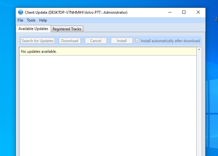

thedarklordzw · 12-Май-25 05:14 (спустя 1 месяц 6 дней, ред. 12-Май-25 05:14)
Any fix to not getting Client Updates after install? Thanks
https://i125.fastpic.org/big/2025/0512/57/ac43f7aee541b09456e2b84fb0771357.jpg
No updates... Been like this for a while
