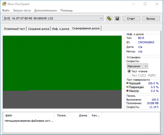

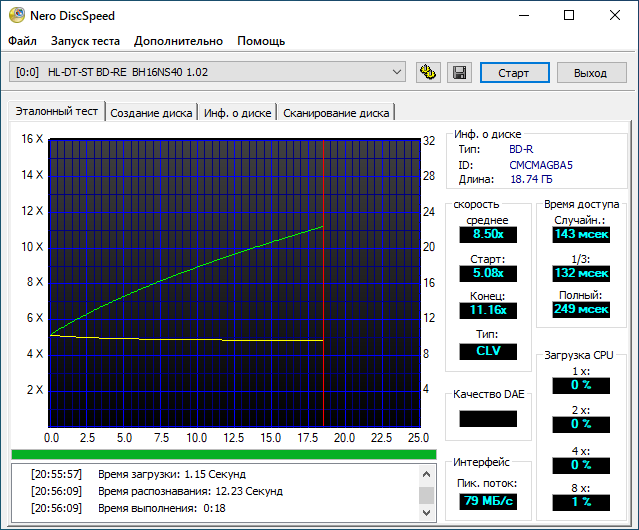

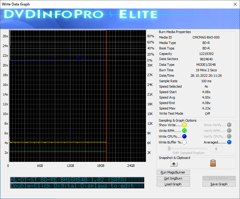

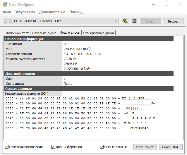

В общем записал на BD-R 25 Гб Жмурки (Алексей Балабанов) [2005, Россия, триллер, комедия, криминал, Blu-ray disc 1080p] Original Rus
Смотреться нормально без рывков
Болванки куплены на озоне: CMCMAG-BA5-000
привод BD-RE Hitachi-LG BH16NS40 2016 года, SVC CODE: NS51, прошивка 1.02.
Писал ImgBurn 2.5.8 на скорости 4x
ImgBurn Log
I 20:09:52 ImgBurn Version 2.5.8.0 started!
I 20:09:52 Microsoft Windows 8 Professional x64 Edition (6.2, Build 9200)
I 20:09:52 Total Physical Memory: 33 477 884 KiB - Available: 29 865 896 KiB
W 20:09:52 Duplex Secure's SPTD driver can have a detrimental effect on drive performance.
I 20:09:52 Initialising SPTI...
I 20:09:52 Searching for SCSI / ATAPI devices...
I 20:09:52 -> Drive 1 - Info: Alcohol V-SATA CD/DVD 1.0d (G:) (SATA)
I 20:09:52 -> Drive 2 - Info: Alcohol V-SATA CD/DVD 1.0d (J:) (SATA)
I 20:09:52 -> Drive 3 - Info: ATAPI iHAS124 F CL9M (H:) (SATA)
I 20:09:52 -> Drive 4 - Info: HL-DT-ST BD-RE BH16NS40 1.02 (F:) (SATA)
I 20:09:52 Found 1 DVD±RW, 2 BD-ROM XLs and 1 BD-RE XL!
I 20:11:21 Operation Started!
I 20:11:21 Building Image Tree...
I 20:11:21 Calculating Totals...
I 20:11:21 Preparing Image...
I 20:11:21 Contents: 28 Files, 15 Folders
I 20:11:21 Content Type: BD Video
I 20:11:21 Data Type: MODE1/2048
I 20:11:21 File System(s): UDF (2.50)
I 20:11:21 Volume Label: JMURKI_BD
I 20:11:21 Size: 20 119 779 430 bytes
I 20:11:21 Sectors: 9 824 128
I 20:11:21 Image Size: 20 120 862 720 bytes
I 20:11:21 Image Sectors: 9 824 640
I 20:11:26 Operation Successfully Completed! - Duration: 00:00:05
I 20:11:26 Operation Started!
I 20:11:26 Source File: -==/\/[BUILD IMAGE]\/\==-
I 20:11:26 Source File Sectors: 9 824 640 (MODE1/2048)
I 20:11:26 Source File Size: 20 120 862 720 bytes
I 20:11:26 Source File Volume Identifier: JMURKI_BD
I 20:11:26 Source File Volume Set Identifier: 555CA16A0095E900
I 20:11:26 Source File Application Identifier: ImgBurn v2.5.8.0
I 20:11:26 Source File Implementation Identifier: ImgBurn
I 20:11:26 Source File File System(s): UDF (2.50)
I 20:11:26 Destination Device: [0:0:0] HL-DT-ST BD-RE BH16NS40 1.02 (F:) (SATA)
I 20:11:26 Destination Media Type: BD-R (Disc ID: CMCMAG-BA5-000)
I 20:11:26 Destination Media Supported Write Speeds: 4x; 6x; 8x; 10x; 12x
I 20:11:26 Destination Media Sectors: 12 219 392
I 20:11:26 Write Mode: BD
I 20:11:26 Write Type: DAO
I 20:11:26 Write Speed: 4x
I 20:11:26 Hardware Defect Management Active: No
I 20:11:26 BD-R Verify Not Required: Yes
I 20:11:26 Link Size: Auto
I 20:11:26 Lock Volume: Yes
I 20:11:26 Test Mode: No
I 20:11:26 OPC: No
I 20:11:26 BURN-Proof: Enabled
I 20:11:29 Write Speed Successfully Set! - Effective: 17 984 KB/s (4x)
I 20:11:43 Filling Buffer... (80 MiB)
I 20:11:43 Writing LeadIn...
I 20:11:44 Writing Session 1 of 1... (1 Track, LBA: 0 - 9824639)
I 20:11:44 Writing Track 1 of 1... (MODE1/2048, LBA: 0 - 9824639)
I 20:30:24 Synchronising Cache...
I 20:30:26 Closing Track...
I 20:30:27 Finalising Disc...
I 20:30:45 Exporting Graph Data...
I 20:30:45 Graph Data File: E:\Program Portable\ImgBurn v2.5.8.0 Portable by BurSoft\ImgBurn\Data\Graph Data Files\HL-DT-ST_BD-RE_BH16NS40_1.02_28-ОКТЯБРЬ-2022-Г-_20-11_CMCMAG-BA5-000_4x.ibg
I 20:30:45 Export Successfully Completed!
I 20:30:45 Operation Successfully Completed! - Duration: 00:19:19
I 20:30:45 Average Write Rate: 17 559 KiB/s (4.0x) - Maximum Write Rate: 17 930 KiB/s (4.1x)

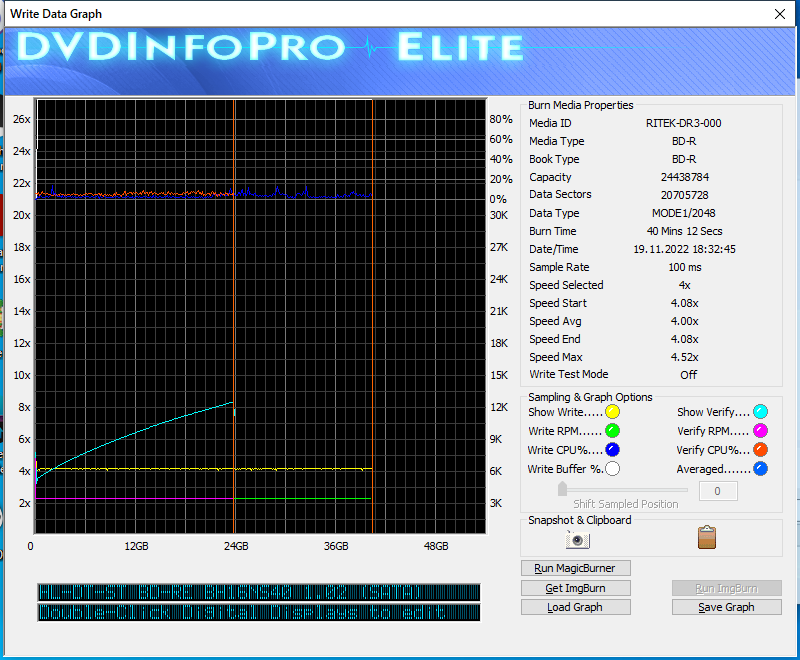

До этого не было привода для записи Bluray.
Брал на алике. Определяются как RITEK-DR3-000 BD RDL 50 Гб. Привод BD-RE Hitachi-LG BH16NS40-NS51 v1.02
Но вот качество дисков ужасное диск писал на 4x ImugBurn , записался нормально но при проверки на 59 процентах выдает ошибку.
При воспроизведение второй половины фильма виснет намертво. при повторной вставки в привод выдаёт что это не пустой bd-rw диск и не воспроизводиться. Попробовал записать следующий болванку тоже на 4x BurnAware Professional 15.9 тоже самое
Привод BD-RE Hitachi-LG BH16NS40-NS51 v1.02 . Брал на озоне CMC 50 гб. Определяется как VERBATIMf (000). Писал ImugBurn На 4x все отлично не проблем при переходе на второй слой. Всё воспроизводиться в отличии от китайских Ritek или Ridata.
